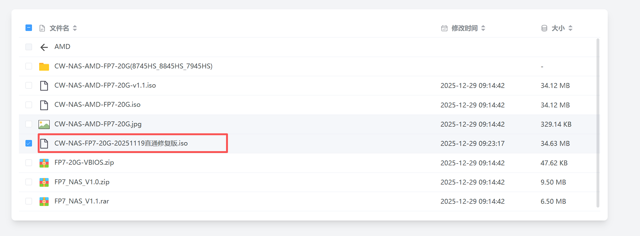

Hello, I just received the CW-NAS-AMD-FP7-20G board. I pushed it through a few tests to see if the CPU and RAM are working correctly, and after such tests were successfully passed, I attempted to install Debian on the brand new Kingston KC3000 NVMe drive. Unfortunately, nearly instantly after Debian tries to access the drive, it starts showing kernel messages about "Buffer I/O error" and "critical medium error", causing the system to no longer be able to detect the drive. What's worse is right after that happens, if I reboot into the BIOS and check the list of NVMe drives, it's... empty. Only after I power off the board completely and boot it back on is when the drive is visible again, but the problem repeats itself when I try to boot into Debian.
I tried updating the BIOS to version 1.1, restoring default settings, trying a known working SSD and using a different NVMe slot, but nothing changes.
Please tell me the board is not broken out of the box and there's a way to fix this... Thank you in advance.
https://drive.x86pi.cn/BIOS/5.NAS-BIOS/AMD/CW-NAS-AMD-FP7-2L-20G
Please try updating to this version first. If the issue still persists, we hope you can provide more system logs for us to analyze the cause.
