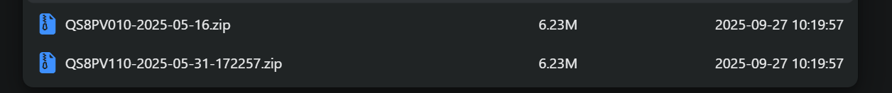

    Hello,
    Which of the two BIOSes from  2025-02-27 is the recommended version?
    Also, is it possible to update the 10gb nic or the asm1164 controller firmware to support aspm?
