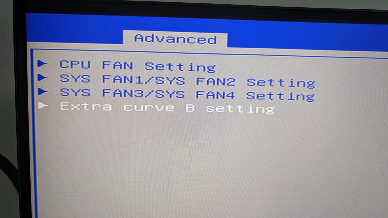

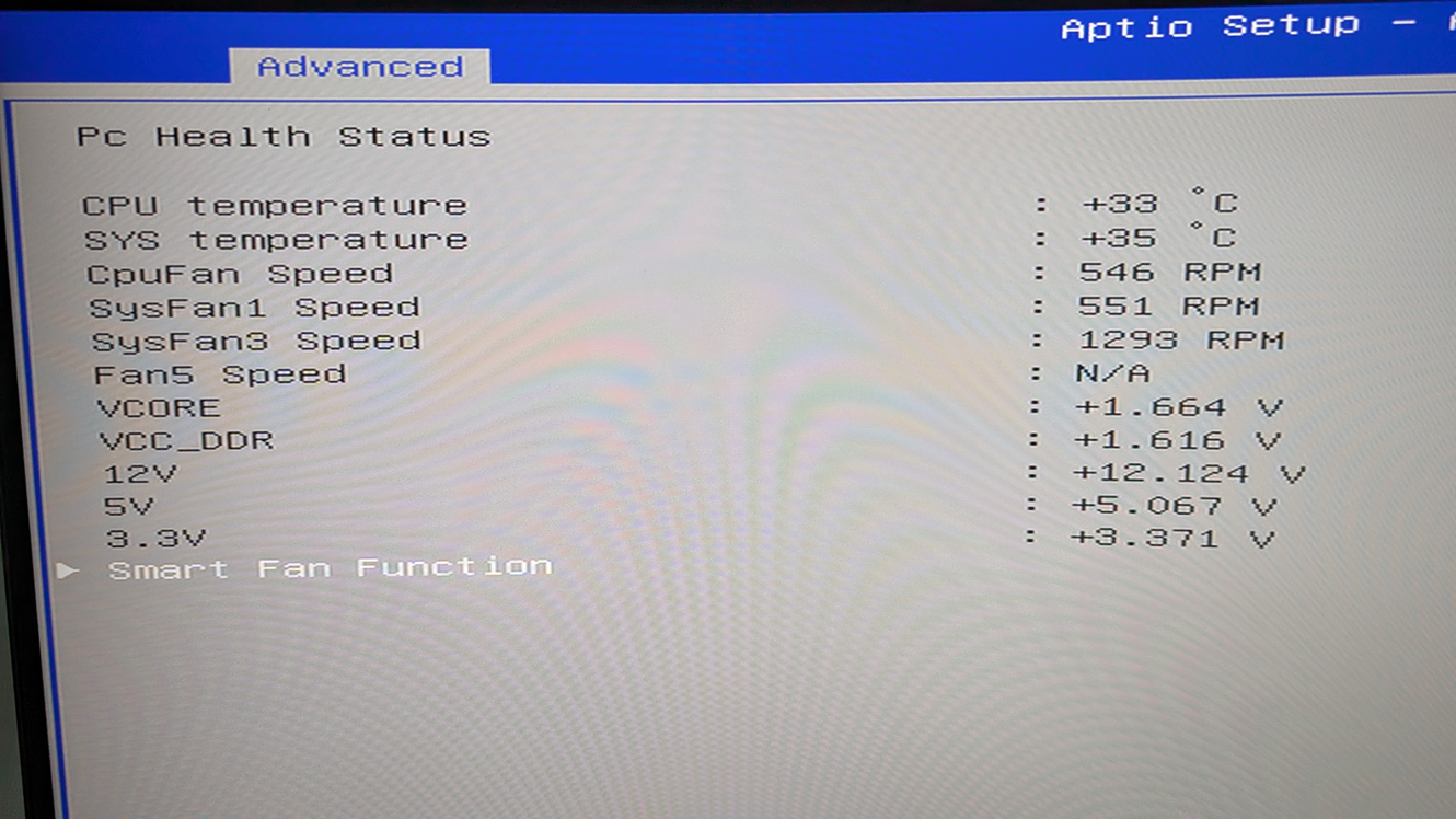

Hi,
It seems like it is only the SYS_FAN1 and SYS_FAN3 that can be controlled (PWM) from operating system in my case Linux.
Is this how it should be?
It the BIOS it seems like SYS_FAN1-SYS_FAN4 should be possible to control but infact it is only SYS_FAN1 and SYS_FAN3.
In addition the CPU_FAN1 can also be controlled (PWM) from the operating system.
I am running the T13 BIOS.
Would it be possible to implement so that more SYS_FANs could be controlled (PWM) by the operating system, or is there a work around?
Thanks in advance!

    Hi @loodd,
    Let me know if you want to provide information with pictures and a list from the pwm directory when IT87 driver is loaded in Debian.
    Also the pictures in the BIOS on the wiki  https://doc.x86pi.cn/#/docs/fs/VXCQuW3XQSosL8RRJL2ixp/235 do not reflect how it look lke in the BIOS T13.
    Let me know when you have an update.
    Thanks!

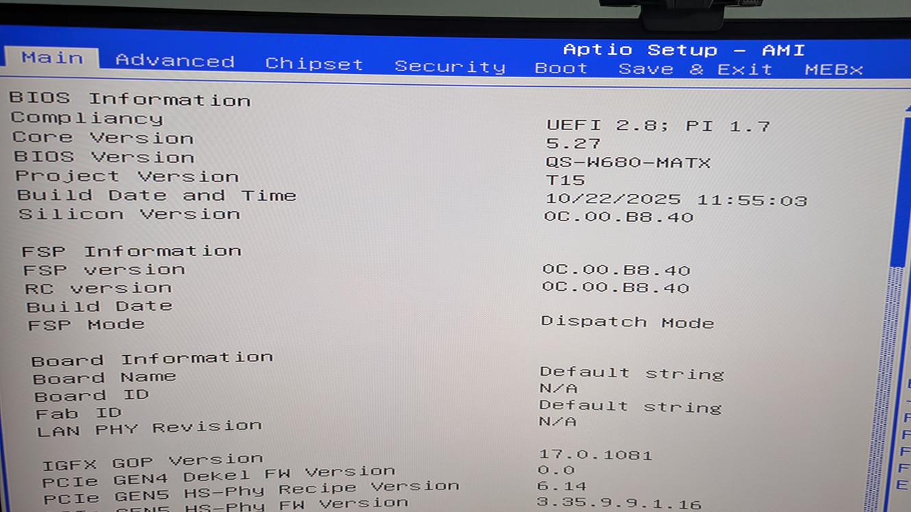

    Hi @loodd,
    The latest T15 BIOS version do not have any improvements regarding the sysfan!
    Could you please state BIOS file name of the BIOS that has the sysfan fixes?
    Thanks!
