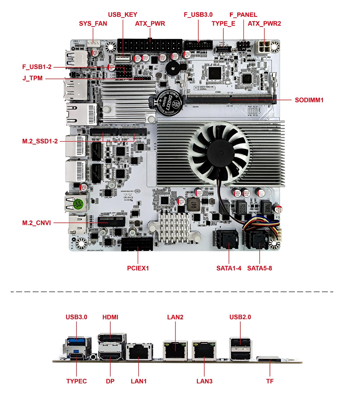

I have a few questions about the CW-AT-10G-8P board. The components of interest are marked with numbers in the image.
1. Are USB ports 1, 2, 5, 6, 7, 8, and 9 independent, or are they wired in parallel?
2. Are USB ports 3, 4, 10, 11 and Type-E independent, or are they wired in parallel?
3. What is the purpose of the connector marked with a question mark?
The description isn't entirely clear; I'd appreciate more detail.
Thanks in advance for your reply.

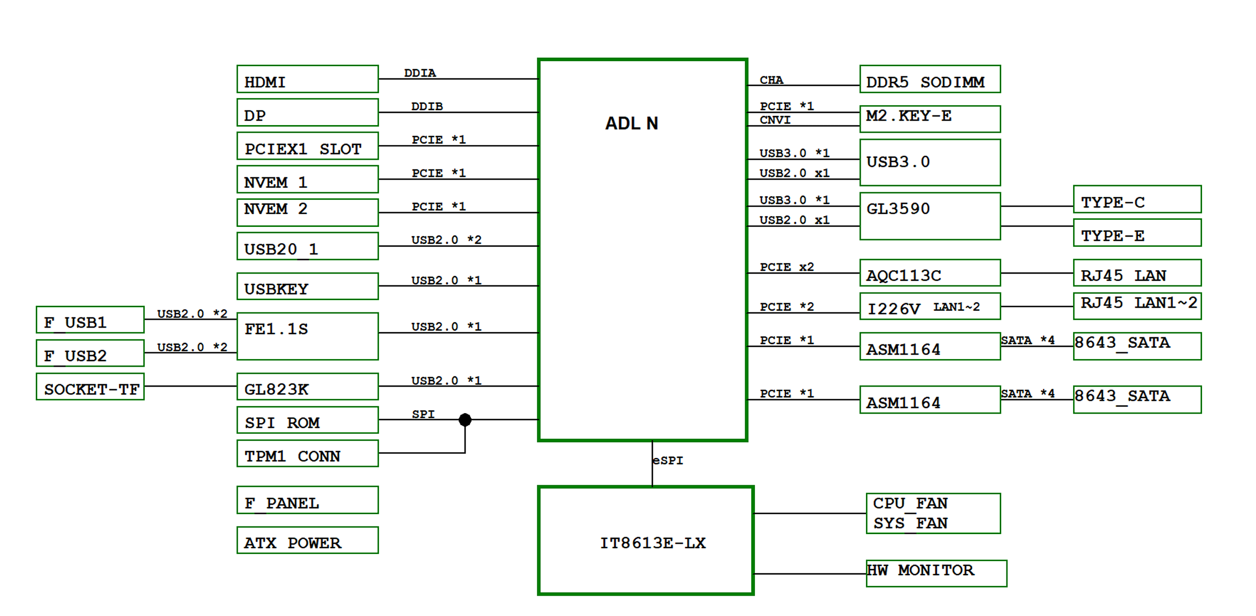

For the interface definition, please refer to Figure 1; for the signal definition, please refer to the resource diagram in Figure 2. Regarding the USB interface power supply, it is grouped in pairs. If anything remains unclear, please describe your question more clearly and completely.
