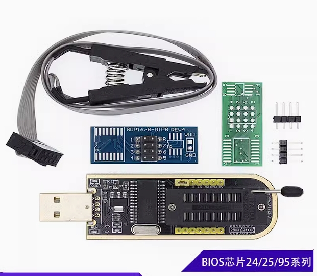

Hi,
I need to know which file you updated, and what is the file name. Based on the current situation, it seems that you may have updated the wrong BIOS, or the update did not complete successfully, causing the BIOS to malfunction. Perhaps you will need to prepare a BIOS programmer, and I can provide you with the correct BIOS file so you can reprogram the BIOS and get the device working properly.
From the link you provided, I have a general idea of the device model. Please tell me the CPU model of your device, so I can further confirm the exact device information and provide you with the correct BIOS binary file.
