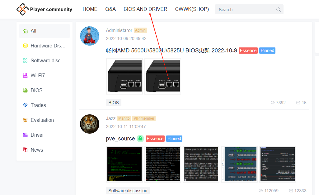

Hello, this one doesn't have a 4*M.2 BIOS ,It can be found in BIOS AND DRIVER. Thank you
https://drive.x86pi.com/BIOS/Intel/3.x86Pi(P1-P2-P3-P4-P5-P6-P7-P8-P9)BIOS/6.X86Pi-P6-Twin%20Lake-N(N150-N250-N350-N355)BIOS/1.x86Pi-P6(M.2%20x4)-N150-N250-N350-N355-BIOS-2024.12.09
